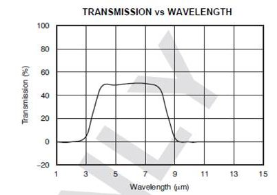

    I might just spend a few bucks and get an ND8 filter and see what happens then (thanks for the pointer to those).  Is there any reference material available that describes the absorption characteristics of the package material vs. wavelength?  (I'm assuming it's not a 'perfect' black body.)
    Is it also safe to assume that going over-range on the thermopile (>125C target) would just result in saturation of the output and not device damage provided that the operating temperature of the part remained within the normal operating range?

  • Clay,
    The TMP006 absorbs IR energy in the 4-8um band, as shown below.
    You are correct - if a hot enough target object was present the thermopile voltage would just saturate at 5.12mV. Unless the TMP006 local temperature exceeded 125C, the part would not be damaged.
