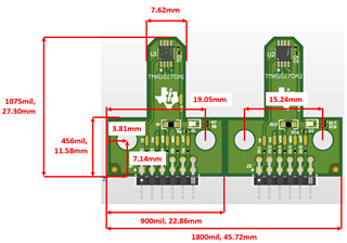

I'm interested to use the your evaluation board but I can't find the dimensions of the board, can you please assist me with this?
Milos
  • Hi Milos, thanks for reaching out!
    I've attached a diagram with the basic dimensions of the TMAG5170UEVM described:
    The EVM contains two identical PCBs separated by a vertical score line in the middle, so the mounting hole dimensions are the same for both separated halves. Additionally, the "arm" containing the IC at the top is centered between the mounting holes.
    As for the sensing element itself, here is its location relative to the left mounting hole:
    Let me know if you need any more information!
  • This is great. Do you also have a step model that you can share (single board)?
  • Of course. I've attached two .step files to this post. SENS083A.step contains the CAD model straight from Altium, with both boards, and TMAG5170UEVM.step has been manually modified so there's just a single board.
