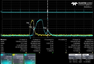

Hi, Supporter,
We encountered the following waveform while using the TDC7201. We are measuring in MODE 1. The Start input uses the same signal as the trigger signal (S1), while the Stop signal receives another signal to measure the rising edge (S2) and falling edge (S3) separately, with a measurement period of 100 kHz. Please see Figure 1, where the green and blue lines represent the INTBx for S2 and S3, the red line indicates the measurement reset operation period (SPI), and the yellow line represents the trigger signal (S1). At the beginning, as shown in Figure 1, the INTBx responds correctly, but occasionally it fails to go low, causing the subsequent process to not respond correctly. What could potentially cause this situation? Could you please provide us with some suggestions?
Thank you.

  • Hello Raimu,
    Thanks for posting to the sensors forum!
    Is it possible to get a capture of the START, STOP, and INTBx signal of a measurement that fails? I would like to confirm what the timing signals look like in the scenario when the INTB pin does not go low.
    Also note that the TRIG and the START pulse should not use the same signal as the datasheet recommends a 5ns delay between a TRIG and START signal on the devices. Is there a way you could try to delay the START pulse from the TRIG to see if this changes the behavior you are seeing?
    For the 67ns wait time, there is some additional margin built into this spec but its not recommended that you provide an additional STOP lower than the 67ns as this extra time is needed to store the previous results and prepare the digital logic for the next STOP pulse. This margin accounts for variation across devices so its possible that you could get a device where its closer to the spec than the device that you tested.
    I hope this helps, looking forward to your response!
    Isaac

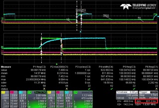

    sorry for lost description. We are using two TDC7201 devices, which together have four cores. The Start input pins of all four cores reference the same trigger signal. One TDC7201 measures the time difference between signals A and B, while the other measures the duration of signal B, which refers to the previously mentioned S2 and S3. Please refer to Figure 2, where the time difference between the TDC7201 output Trigger and the Start input is greater than 500 ns.
      Figure2
    We understand that the timing specification requires the two Stop signals to be separated by at least 67 ns. However, in NUM_STOP, a single core can receive a maximum of five Stop signals in one measurement. In practical operations, it is not guaranteed that the intervals between Stop signals will be greater than 67 ns. We would like to inquire how the TDC7201 would behave if the interval between Stop signals is less than 67 ns (the lowest time we have currently observed is 40 ns).

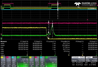

    Additionally, regarding the relationship between the Start (yellow), Stop (red), and INTBx (blue) signals that you wanted to understand, please refer to Figure 3.
    P.S. The green signal represents the Trigger output from the TDC7201.

  • Hello Raimu,
    Thanks for the information that clarifies things a bit. If the STOP is lower than the 67ns you can run the risk of the AFE not being ready for the STOP signal so the system will not recognize that it has received a STOP.
    Do you know how many STOPs the device was configured for in the scope shot above and do you know what the pulse width is for the STOP pulses? My only thought at the moment is that perhaps the pulses were not recognized as valid pulses hence why the device still thinks the measurement is happening and the INTBx remains high.
    Isaac

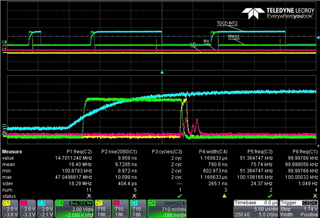

    By the way, I would like to ask about the following questions regarding the graph (sometimes the Stop signal looks like the letter "M"):
      Figure 4
    1. How does the 7201 determine the Stop signal? We know that the interval between STOP signals needs to be greater than 67 ns. In our actual readings, we have found that the TIME2 register sometimes has a non-zero value, and at times it is the same as the TIME1 register value. Under what circumstances does the 7201 consider there to be two STOP signals?
    2. Will different TDC7201 chips read the same edge signal values the same way? For example, the rising edge of the Stop signal.

  • Hello Raimu,
    1.  If I understand correctly, you mean that the TDC7201 may not be able to correctly receive signals with a duration of less than 67 ns, rather than the AFE, right?
      1. Correct the TDC7201 may not be able to correctly interpret signals if the duration between stops is less than 67ns, rather than the AFE.
    2. How does the 7201 determine the Stop signal? We know that the interval between STOP signals needs to be greater than 67 ns. In our actual readings, we have found that the TIME2 register sometimes has a non-zero value, and at times it is the same as the TIME1 register value. Under what circumstances does the 7201 consider there to be two STOP signals?
      1. I would need to check with my design team so see how the logic is configured internally. Just to confirm is the time length between the first peak to the next peak less than 67ns?
    3. Will different TDC7201 chips read the same edge signal values the same way? For example, the rising edge of the Stop signal.
      1. This is a setting within the device in the TDCx_CONFIG register. The STOP_EDGE register defaults to reading rising edges but it can be configured to read falling edges if preferred. So unless if the user changes this the default is always rising.
    4.  I would like to ask how to calculate COARSE_CNTR_OVF.
      1. Do you have a target value of when you would like the overflow to occur? For example if the measurement is 1us then the interrupt bit should be set? If you provide the target value I can help on how  that should be calculated.
