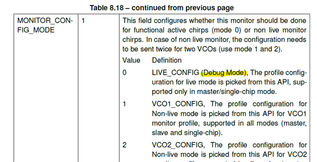

Q1) According to the previous answer, AWR1843 supports "Synthesizer frequency monitoring" in "Live mode" only.
Table 8.18 in "Interface Control Document" says it is "Debug Mode".
The customer wonders if the feature can be used only for debug. Is this future supported for production?

    I think you might be referring to a different version of the ICD which might not be completely applicable for AWR1843. You can use the below version.
    5758.mmWave-Radar-Interface-Control.pdf
    Please refer to version above. This monitor can be used in production as well if required by the customer.
