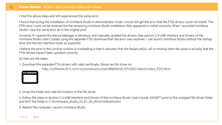

  • Hi Aozer
             Thanks for your response.
              I have tried with various Microsoft Visual C++ but still stuck with same error.
             As per my understanding updating FTDI driver has no relation with opening a DLL file nor the file require Physical DCA1000 and AWR1243 connected.
    Hoping for help and support.
    Gopal
    Ok, but did you try the method described in the thread? It has worked for other users so it may work for you. You are correct that it should not impact DLL search but it has worked for others. If you search on E2E there are several threads where this has fixed the same error.

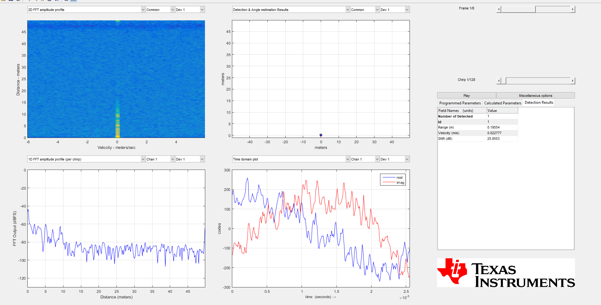

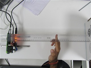

           I have performed some test using the radar.
    Test01.JPG were an object is placed at 8cm.Test_001.JPG is the snap shot of the result in mmwave studio, the detection results shows 0.19m(19 cm). But, the 2DFFT Plot is quite different.
    Test02.JPG were an object is placed at 40 cm.Test_002.JPG is the snap shot of the result in mmwave studio, the detection results shows 0.58m(58 cm). But, the 2DFFT Plot is quite different.
    Gopal
    I suggest you review the below app note to understand different radar parameters and how they impact performance.
    https://www.ti.com/lit/an/swra553a/swra553a.pdf
    If you are seeing large errors in range detection you may need to look at how you are setting the range resolution. If you want to detect close objects with fine range you need to configure the device to maximize your range resolution. You can also look at the sensing estimator which can help you setup a chirp configuration for your desired use case.
    https://dev.ti.com/gallery/view/mmwave/mmWaveSensingEstimator/ver/2.4.0/
    Adrian

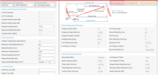

  • Hi Adrian
       I am referring the pdf for the calculations. I even made an Excel which calculates these things.
        I have feed the data as per your suggestion in mmWave Sensing Estimator and calculated back Max Range, Range Resolution ,Max Velocity and Velocity Resolution.
    As per the observation the values of Max Range and Range Resolution is correct but value differ in Max Velocity and Velocity Resolution.
    Can you please have a look and let me know the error.
    Apart from that if i try to fill the values which i have obtained from mmWave sensing estimator into mmwave studio.
    mmWave studio does not accept Sample rate less that 200. And pops out the following error message.
    Gopal
    For 12xx the minimum valid sampling rate is 2Msps.
    For sensing estimator computations, I will loop in the software team.
