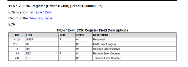

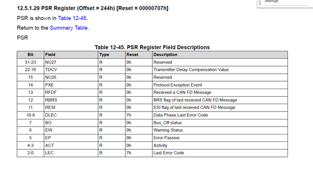

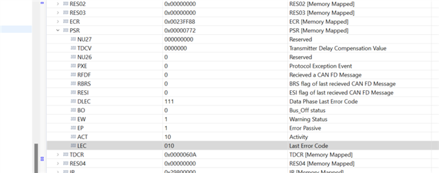

Hi Ti support,
Can you explain clearly the conditions for the appearance of these parameters? It is very clear in the manual and does not need to be explained.

Are you sure? What do these parameters mean? Can you find it out for me? What do their values mean?
Hi Ajay
For example, what does Field mean for ACT; what does Field mean for PXE?
Hi Ajay
For example, what does Field mean for ACT =1 ; what does Field mean for ACT = 10?
