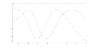

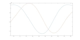

  • This is output signals from differential 16 bit(oversapled from 12bit) ADC. Vadc_ref is 3.3 V.
    First image is output from LDC5072. Second one - from IPS2550.

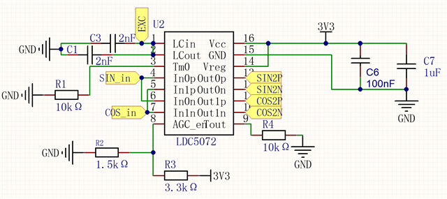

    Here is schematic. Layout cant send. I will make capture of the exciter tomorrow. But It was just sinus with amplitude around 3V without drops and spaces.

    On your schematic, it looks like the exciter coil is connected only to the LCIN pin.
    is that correct?
    John
  • Nop. There is connection to LCout near the pin.

  • Kirill,
    A couple of things to try:
    1. Your schematic doesn't show any pull-up or pull-down resistors.
      Could you try adding some 5k-10k pull-up resistors from the output pins to 3.3V to see if that helps?
    2. The COUT resistors are at the high end of the recommended values.
      Could you try some smaller values from the output pins to GND to see if that helps?

    Every 100 us(first picture in the 4th post). Looks like PLL with slow feadback.

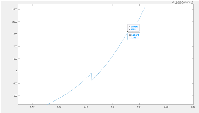

  • It always ripples with ~100 us period. And Out singnals(Sin and Cos) ripple synchronously. Sin/Cos ratio is stable. But near the zero level , clear steps(whyle moving) are observed(1st picture in the init post). And after I installed 100 nF capacitor to output, they(steps) are gone.
    I think this is not expected.
    This is linear encoder. On the 1st picture real resolution y-16bit dif ADC out(from outp to outn pins), x- time in seconds. There is 1 period per 0.1 second.

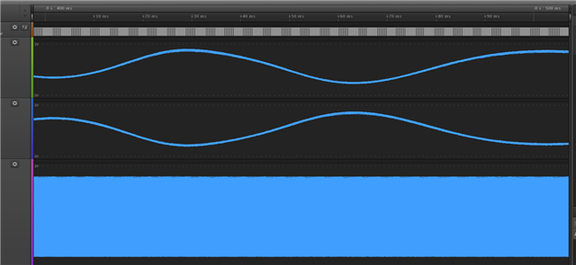

  • I found the pulsation cause. Its enabling RS485 communication... I checked twice power supply. Its OK. I didnt see pulsation on my plots, because I read ADC, send data via RS485 and it begins. RS485 lines is shielded (and doesnt affect absolutely same PCB with ILS2550)
    Here is plot with 1nF Cout on red line, and without Cout on blue.
    And capture of RS485 data line, Out1p, Out1n and LCout

  • Sorry. This device already in production(and in validation with IPS2550). This is prety standart square Exciter coil out, and two sin and cos coils inside. Sin and Cos coils have 2 periods size. Exciter - 2.5 periods. Exciter has no capacitive coupling with input coils. There is full grouning with gap to coils around 1.6-1.7 mm. Sensor size is 15 x 10 mm.
    Here is the zoom of steps. 2^15 is equal 3.3 V (in dif). So steps are about 33 mV. At the high speed they are smaller. The main problem is that they are clear without any noise. I dont understand this. It looks like IC schematic problem in PLL or peak detector(signal phase control). But why do output capacitors help?..
