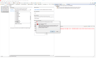

When trying to connect to the cores in CCS debug, I am getting this error:
Error connecting to the target:
(Error -1170 @ 0x0)
Unable to access the DAP. Reset the device, and retry the operation. If error persists, confirm configuration, power-cycle the board, and/or try more reliable JTAG settings (e.g. lower TCLK).
(Emulation package 12.7.0.00130)
However, even after much power cycling, and resetting, I am still getting the error.

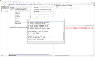

When I test out the connection in Target Configuration, I am getting -233 SC_ERR_PATH_BROKEN error:

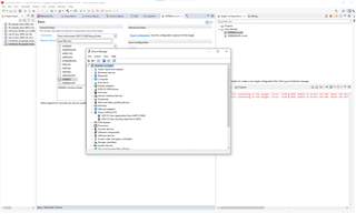

The COM ports are still showing up on device manager :

    The device manager with the ICBoost shows the correct XDS ports. COM2 Class Application/User UART and COM1 Class Auxilary/Data Port in my case,

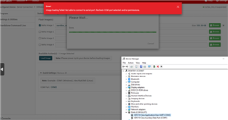

    Here's what happened:
    1. Flashing the device again
    I needed to flash the device again, but I was unable to do so in this configuration: usb to xds110 on the icboost + iwr6843 + dcjack powersupply:
    But I managed to flash the device in this configuration: usb to xds110 on the icboost + usb to iwr6843
    2. Testing on CCS debug
    Following that, I tried using CCS debug target configuration to test connection JTAG with this configuration: usb to xds110 on the icboost + usb to iwr6843. It worked well, the scan path integrity shows pass in the checks.
    I then tried to test the connection with this configuration: usb to xds110 on the icboost + iwr6843 + dcjack powersupply. Surprisingly, it passed the scan path integrity checks as well. However, after a power cycle/NRST reset, the same error of -233 SC_ERR_PATH_BROKEN happens again.
    Now, I am unable to get this configuration: usb to xds110 on the icboost + iwr6843 + dcjack powersupply, working again for ccs debug, regardless of how many times I reconnect/ powercycle.
