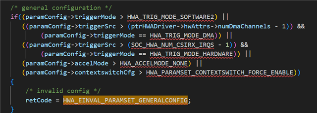

AWR2944: cfar config error -2820
Part Number: AWR2944
In awr2944 tdm demo, cfar config occur error -2820. I search the error code, find it's hwa common config error. what shoule i do to solve the problem?
  • Hi Peng,
    Error -2820 corresponds to HWA_EINVAL_PARAMSET_GENERALCONFIG. Can you please recheck the errorcode? Also use the latest SDK 4.6.1.2. Did you make any change in the SDK?
    Samhitha
  • Sorry, the error code is -2820, the screenshot is wrong. And sdk version is 4.6.0.1, i make some change in rangeDPU and dopplerDPU(mmw_resTDM.h)

  • I find the reason is triggerSrc. triggerSrc=34, it occur error, if triggerSrc=0, it work ok.
    Another question: If range DPU use paramset index is: 0-5, doppler DPU used paramset index is :6-33, so cfar dpu used paramset start index can begin 34?
  • Hi Peng,
    Yes, you can use the paramsets which are not in use. So, RangeCFAR paramset start index can be 34.
    Samhitha
  • when  paramset start index set to 34, it occur error, error code is -2820.
  • The current situation is:
    range DPU: paramset index: 0-5, total 6
    doppler DPU: paramset index: 6-33, total 28
    cfar paramset start index set: 5, 6, 10, 20 etc, error code is -2808;
    cfar paramset start index set: 33, 34, 40 etc, error code is -2820;
  • Hi Peng,
    I will check and let you know by early next week.
    Samhitha
  • Hi Peng,
    In the current TDM demo, we are reusing the dopplerproc paramsets to configure the Cfar paramsets. If cfar paramsets configured after the end dopplerproc paramsets, I don't see any issue. Seems like there is something wrong with the paramsets that you have added. Please check it at your end as the issue cannot be reproduced at our side.
    Samhitha
