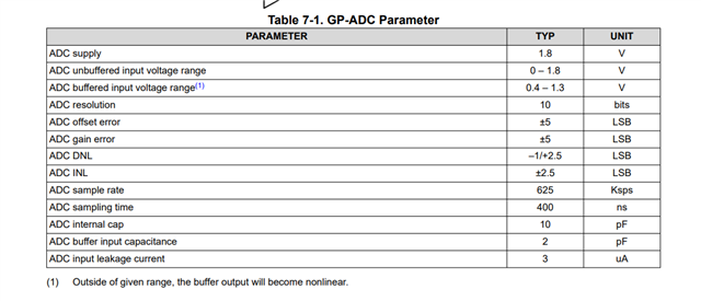

Hi team,
I want to check if every GPADC is buffered or not, but there is no information about this in datasheet or TRM. And I checked the SDK, it seems there is no explicit setting about buffered ADC. How to check this?
Shawn
