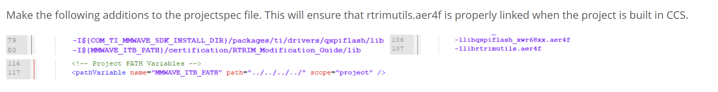

  I follow the description "option 1" in this link "RTRIM API Users Guide (ti.com)" to modify DSS code in 3D People Tracking. The compilation is failed, is the method available for DSP?

    Your project's linker is potentially not pulling in "ti/utils/rtrim", so it cannot find that file during compilation. Was this part of step 1 done?

    As stated in the guide, the change must be done as followed "NOTE: For demos which include both a R4F as well as a DSP, this file will be mss_main.c, but the modifications will be the same."
    Meaning DSS shouldn't have any reason to try and refer to that file, including dss_main. Only mss_main

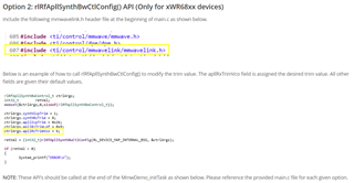

    In the other ways, can I add the changes (follow option 2) into dss_main.c in my case?
    My changes is like as below.
    static void Pcount3DDemo_dssInitTask(UArg arg0, UArg arg1)
        System_printf("Debug: DPM Module Sync is done\n");
        rlRfApllSynthBwControl_t ctrlArgs;
        int32_t retVal;
        memset(&ctrlArgs, 0, sizeof(rlRfApllSynthBwControl_t));
        ctrlArgs.synthIcpTrim = 1;
        ctrlArgs.synthRzTrim = 8;
        ctrlArgs.apllIcpTrim = 0x26;
        ctrlArgs.apllRzTrimLpf = 0x9;
        ctrlArgs.apllRzTrimVco = 6;
        retVal = (int32_t) rlRfApllSynthBwCtlConfig(RL_DEVICE_MAP_INTERNAL_BSS, &ctrlArgs);

    Yes only in mss_main.c. RTRIM is not so much a core related thing but involves front end registers. Meaning doing it once within R4F/MSS main.c will also affect DSP/DSS. In theory it shouldnt really matter whether it's done in in dss_main or mss_main, but with the way we have the SDK and Fundamentals demo setup, we chose MSS. What made you think rtrim_set() should be done in DSS?

    The RTRIM setting does not affect the DSP clock, it is the APLL generation that we are optimizing with this setting. That being said, you are correct with the location of the "rtrim_set(6);" line.
