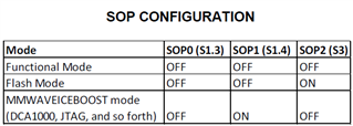

I'm working on a custom board for the awr1843aop based on the awr1843aopevm board, and I had a question about what SOP mode corresponds to which states. Looking at the schematic found  for the EVM board it says that the SOP configuration follows the list below:
After checking against the hardware checklist for the same device, I found that it says that the SOP should be set like below:
Please let me know which configuration list is correct for the awr1843aop. Thank you for your time.
