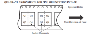

Hi team.
Could you point out which is the pin 1 direction in the carrier?

Hello Leo,
Pin 1 will be in the first quadrant (Q1) of the tape. Please see the image below:
