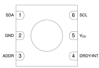

One question on HDC2080 and dc2022.
From the datasheets of the above 2 sensors on temperature calculation,
HDC2080 says:
while HDC2022 says:
Between 40.5 and 40, which has a better result for temperature?
2) Could you advice what indications the LED indicators (red, green and blue) on the EVM are assigned for?
  • Hello Eugene,
    Thanks for your questions.
    For Question 1: The HDC202x devices have a centered circular sensing cavity (Figure 1) while the HDC2080 has a slightly offset (from the center) rectangular sensing cavity (Figure 2).
    This has resulted in the variation between the temperature equations for both devices.
    For Question 2: We're unsure what the intended function of those LED's are and are unable to confirm since these are older EVM designs.
