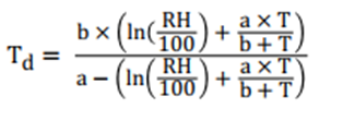

I saw in the spec that it is necessary to continuously detect the dew point to determine the condensate water, and judge the condensate water based on the dew point.
The calculation formula for dew point    mentioned in the document   ''Using relative humility to derive vapor pressure, Dew Point, Absolute Humidity, and Enthalpy. ''   Where T refers to the air temperature.
But my device has just been taken out of the cold storage, and it must be cold. At first, the device can only measure its own temperature and cannot measure the temperature of the air outside the cold storage.
That is to say, the current HDC3022 cannot know the dew point temperature outside the cold storage. So how can I determine if condensation has occurred?

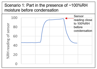

    On the HDC3020, we have consistently observed that:
    • in the presence of ~100%RH moisture before condensation, the sensor will read close to 100%RH and as saturation occurs there will be a sudden drop in the RH reading due to water drop formation on the polymer surface.
    • if water drops are on the sensor itself, there will be a sudden drop in RH reading to 0%RH, and then a sudden increase in RH reading when the water regresses from the polymer surface.
    We haven't done condensation testing with the HDC3022 yet, so we would need to check if it behaves in the same way or not. The HDC3022 has a IP67 filter for dust and condensation protection, so that doesn't mean condensation won't happen but the filter should protect the polymer in this case.

    We have tested the HDC3020 in high-humidity condensing environments and it looks similar to the HDC3022 data you shared. The part reads close to 100%RH, and then as saturation occurs there is a sudden drop in humidity due to condensation water drops on the sensor. The HDC3022 data levels off more slowly though. The graph below comes from HDC3020 data.
    Is your goal to prevent condensation on the sensor, or to detect if/when condensation occurs?
    Since removing the device from cold storage causes such a sudden change in temp/humidity, monitoring the change rate should reliably detect when the device has been removed and condensation is likely to occur. Then the heater can be run to prevent condensation forming. If the device will not be used in a high-humidity environment, then perhaps you could also set an absolute threshold at ~90%RH.

  • Hi Victor,
    I tried to attach the .png image again, I hope you can see it.
