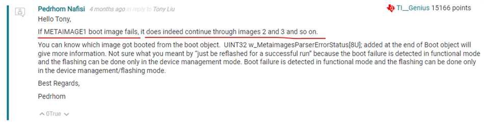

I'm curious if ROM bootloader could load META IMG2 alternatively when META IMG1 is corrupted.

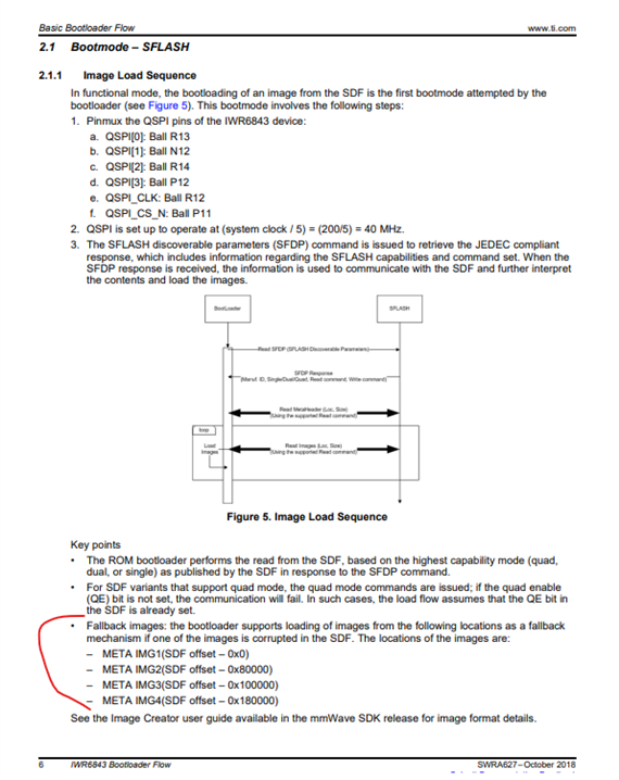

When looking application note(mmWave xWR1xxx/xWR6xxx Bootloader Flow), there is below description of 'Fallback images'.

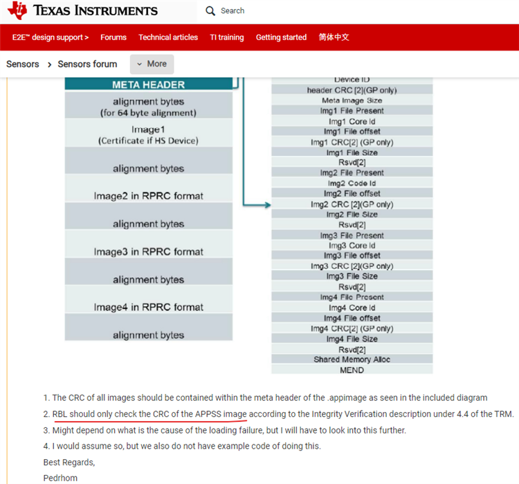

Also, when looking below E2E thread, there is below comments.
https://e2e.ti.com/support/sensors-group/sensors/f/sensors-forum/1343473/iwrl6432-rbl-fallback-scheme-if-image-is-corrupted/5157539?tisearch=e2e-sitesearch&keymatch=fallback#5157539
Here are my quesitons.
1. Does 'Fallback feature' mean "If METAIMAGE1 boot image fails, it does indeed continue through images 2 and 3 and so on,"?
2. Does AWR6843AOP has the Fallback feature?
3. Can you please provide some examples when the boot fails? Maybe QSPI communication error / CRC check error / etc?
