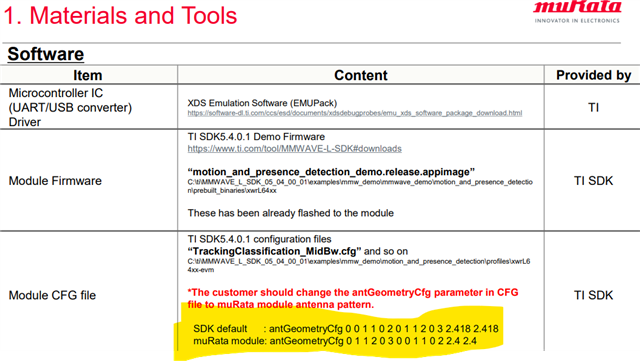

2. I am supposed to change a parameter in: CNG file since the designed antenna is different from what TI's EVB. Where is this file please?
See partial requests by MuRata :
by the way I'm using the latest version(SDK 05.05.00.02)
    The configuration file is sent to the device upon start up in the out-of-box demo. It can be found at the path Murata sent to you in the screenshot.
