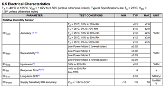

1. After interfacing we found that the sensor readings are not matching with the accuracy mentioned. We are using Rotronics Hygro clip model (+/-0.2°C and +/-0.8%RH Accuracy).
2. What is the life of sensor with respect to its accuracy and its quality.
3. Does it has drift issue in high humidity application like stability chambers, were its humidity reaches to 100%RH after turning off.

    What are the temp and humidity conditions that the HDC3022 is being operated and stored at? What RH measurement and error are you seeing on the HDC3022?
    The HDC302X has a long-term drift spec of 0.19%RH/yr. However, prolonged exposure to high humidity can cause the sensor reading to shift as the sensor absorbs excess moisture. The IP67 filter should protect the sensor polymer from external liquid water and it will take longer to fully saturate at high humidity, but left long enough at 100%RH and the filter will eventually reach 100%RH and sensor will absorb moisture. To recover or reduce the error, you can perform a bake + rehydration; see the suggested procedure below.
    1. Baking: 100C, at less than 5%RH, for 5-10 hours
    2. Rehydration: 25C and 50%RH for 5 days
    You can also use the built-in heater to bake out moisture and correct a positive RH error. You may need to experiment to see how much offset can be removed and which heater conditions work best in your application. The settling time and peak temperature attainable by using the integrated heater will be largely dependent on the board layout and the operating voltage of the device. See datasheet section 7.5.7.7-8 on how to enable and configure the heater.

    I have one query and doubt, in my application i have used 3.3VDC as supply voltage for sensor, but in datasheet although the supply range is 1.62- 5.5VDC the testing parameter is given on 1.8VDC so do i have to use 1.8VDC for sensor to achieve given standard RH accuracy?
  • Hi Manthan,
    The RH accuracy max spec is applicable for the entire supply range 1.62-5.5Vdd. The typical spec comes from characterization data at 25C, 1.8Vdd. We also specify the Supply Sensitivity RH accuracy, which addresses the max PSRR you should see across the supply range 1.8-5.5Vdd.
