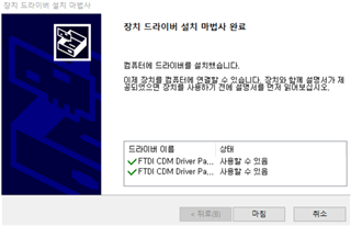

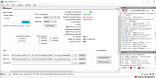

After connecting the DCA1000 to the PC and installing the drivers, I turned on the power, but the XDS port is not visible in the device manager. Please help me see the XDS port.
You will also need a USB cable from the 6843AOP on the thinner side to the computer.
Pedrhom

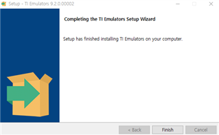

as you mentioned, I connected the thin part of the 6843AOP to the computer, but the XDS port is still not visible. Are there any other solutions?
hui ho jeun
Hello Hui Ho Jeun,
Put the switches on the front side all to the downwards/off position. Also as a bit of a last resort, but try downloading and installing Code Composer Studio. It comes with drivers for many XDS debuggers that Texas Instruments uses and will automatically install them along with the tool itself. The tool itself is meant for writing/debugging application code for TI devices, including Radar.
https://www.ti.com/tool/CCSTUDIO
If neither of these options work as well as hardware changes such as changing USB cables, USB port, or computer; then I will deem the radar EVM itself as faulty.
