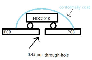

My device uses HDC2010, but condensation always occurs on the device during use. Due to condensation, the pins of HDC2010 are short circuited.
May I ask how to waterproof HDC2010?
Can I apply conformal coating to HDC2010?

The humidity in the usage environment is very high, and condensation water is easily generated.
Due to customer requirements, we can only use HDC2010.
We know that the humidity sensing part of HDC2010 is located on the bottom of the chip. We plan to open a hole with a diameter of 0.45mm on the PCB directly below the chip. The top of the chip is covered with conformally coat. Do you think this plan is effective?

I don't believe the proposed idea to conformally coat the part and add the hole under the PCB would solve the condensation problem. As the coating only really applies to the upper part of the sensor and not the sensing element. There would also be a risk of the conformal coat out-gassing and causes RH reading errors since the sensing element would be exposed due to the hole exposing the sensing element during the coating process.
Additionally, have you tried running the heater in the part to try baking out the condensation on the sensor? You can find more information on it on page 9 of the datasheet.

The purpose of waterproof coating is to prevent the pins of HDC2010 from being short circuited by condensed water, not to prevent the sensing element from getting wet.
I thought I applied waterproof paint on top of HDC2010 so that when condensation occurs, HDC2010 won't be short circuited. At the same time, a hole is opened directly below the chip so that the sensing element can come into contact with air and detect relative humidity normally. If there are no holes here, the sensing element will be isolated from the outside air.
Meanwhile, due to the limited space near the PCB holes, it is not easy to generate a large amount of condensation water.
If I don't apply conformally coat, when condensation occurs, HDC2010 will short-circuit and it won't work. The heater cannot be turned on.
Or Do you have other ways to make a judgment before condensation occurs, turn on the heater to prevent HDC2010 from short circuiting.

I agree, short circuiting at the pins would still be a problem. You can certainly move forward with a conformal coat, but I would recommend checking out this document on more information for what chemicals to avoid to prevent possible drift in the HDC2010 RH readings.
I also can't say for sure whether the hole would be sufficient enough (in size) for the device to obtain meaningful measurements. I would suggest making a small batch of these with the hole (or various sizes of the hole) and conformal coating and testing them against the original setup to see how they perform.
