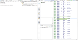

1.awr2944 running normal,wave normally.
2.in dss, inject a array overflow, (maybe cause a stackover or wild pointer),  dss running out.
3.now i call <SOC_generateSwWarmReset> in mss.
4.in most cases, soc run nornally.
   but i find 2 unexpected performances. and the reproduction frequency is very very low.
①.stop in boot like this.
②.its very difficult to describe.only show me that i cannot connect to mss with xds110.and the current is more than only run boot, less than run app.
my question is :
what operation should i do before i call mss warmreset to avoid this.
