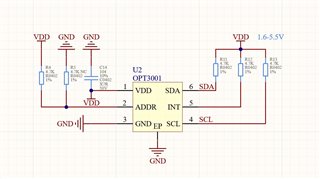

After storing the sensor at a high temperature of 85 ℃ for 60 hours, it was found that I2C communication was normal but the reading of light intensity failed.
Even after 24 hours of storage at room temperature, the light intensity could not be read normally;
At this time, when reading the data register 0x00 of OP3001, it was found to be 0; Then use i2c tools to read and write OPT3001 registers for debugging, dump all registers,
and find that IIC communication is basically normal, and the value of register 0x00 is 0;
Attempting to manually write configuration, after modifying the 0x01 register, it was found that the value of the data register 0x00 was not 0. At this time,
using the original program to read, sensor data can be read normally Read and write the register again, it works normally together;
The schematic and register print refer to below:

  • Hello Zhang,
    Could you please share the contents of register 0x01 before and after you changed the configuration? It could be possible that you did not switch the device mode out of shutdown, which is why the device output was reading 0.
    Thank you,
    Daniel Balmaceda
  • Hi Daniel,
    The previous we have shared the I2C register log and it is the total dump register configurations;
    Our I2C tools read the register high and low bytes are opposite and we need to manual swap, the 0X01 register bit10:bit9 is 0b10 or 0b11,
    it is not the shutdown mode, thanks.
  • Hi Daniel,
    Is there any comment for this issue, thanks?
  • Hello Zhang,
    I apologize for the late response.
    As per the datasheet, he maximum operating temperature of the device is 85 C; however, it is not recommended to expose the sensor to this temperature for a very prolonged period of time. How are you storing the device? Is there any humidity present as well?
    The fact that it is still working after some time seems suggests that this failure was temporary due to the high temperature.
    Thank you,
    Daniel Balmaceda
