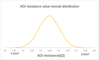

I use a variable resistor to adjust Bop on a custom board, taking into account Bop Acc (Radj).
I assembled 40 custom boards and checked the variation in Bop, and found that it was very small, so I am thinking of changing the variable resistor to a fixed resistor when moving to the next prototype.
I understand that Bop Acc (Radj) is ±0.85mT for Bopset (3-4mT).
I would like some advice on whether the variation in this lot just happened to be small, or whether it would be okay to change it to a fixed resistor.
I understand that variation occurs within the specifications of the data sheet, but I have a question.

    The +/-0.85mT accounts for any possible process variation that could occur. Typically you would see a nice gaussian distribution similar to what the data you captured, so the possibilities of seeing some on the ends of the +/-0.85mT would be more unlikely.
    My recommendation would be to build based on the specification, so the option on keeping the variable resistor or going to a fixed resistor is dependent your system. If you are able to afford a change in accuracy of up to +/-0.85mT then I think you should be fine moving to a fixed value. But if the actuation point on your system is more sensitive and you require fine tuning the it might be  worth it to keep the adjustable resistor.
