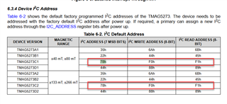

We have a question about the TMAG5273C1/C2.
According to the I2C specification, 78h is reserved for 10-bit addressing.  However not sure if 78h is supposed to be used for 7-bit addressing according to the I2C specification.
Our I2C slave is NAKing this 7-bit address, which seems to make sense since it's reserved for 10-bit addressing.  Do you know of any errata I could take a look at for this part?
