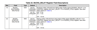

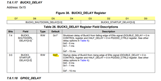

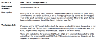

Regarding the above, if I cannot input 1.8V before 3.3V, please provide a reference circuit.
