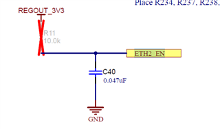

When we use the DP83720S chip, the drive does not respond, the 25MHZ crystal oscillator is not output, the power supply of the chip is positive, and the reset is high; What is the reason

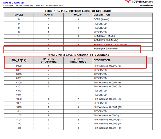

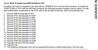

Please read section 2.4.3 of the user guide.
https://www.ti.com/lit/ug/sprujb0/sprujb0.pdf
