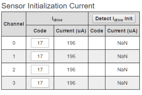

    In GUI, if "Detect Idrive Init" button is pushed, Idrive value is not recommended.
    So i adjust Idrive by observig the voltage waveform of INxA by oscilloscope.

    3) Is it a GUI bug that Idrive value is not recommended even "Detect Idrive Init" button is pushed ? or any setting wrong ? Currently "NaN" is shown.

    3)  Looks to be a bug.  I have not found a way to make it work.
