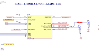

Hi Expert
Do you know how can 2544 output a 25MHZ clock? We can't find it in SDK and reference manual.
Hi Expert
Hi Jiang,
The OSC_CLK_OUT and OSC_CLK_OUT_ETH are analog pins, and these outputs should come out of the pins by default without any additional configuration.
Can you measure the signal on these pins when the device is operational and confirm what is the signal you see on the pin?
Ajay
