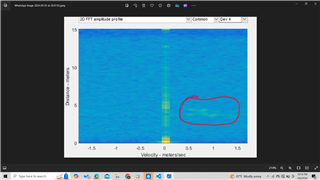

MMWCAS-DSP-EVM: Try to capture moving motor bike , NOT clear object in the Range doppler map
Part Number: MMWCAS-DSP-EVM
I have used two lua script.
01.Cascade_Configuration_TestSource ( For the real time object capturing disable the test source )
02.Cascade_Capture
after running this i am not able capture motor bike correctly but i can see small difference in the range doppler map. can you guide us how to capture the moving object correctly  in the range doppler map. ?  can you share the related documents other than user guide.
is this the object or not ? and how can we capture object correctly  ?
  • Hi Senal,

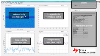

    To check the captured data of the multiple frames, you can use the sliders in the post-processing window and see if there is any difference.
    For post processing in MATLAB, you can refer to mmwave_studio_02_01_01_00\mmWaveStudio\MatlabExamples\4chip_cascade_MIMO_example.
    You can also refer to "C:\ti\mmwave_studio_03_00_00_14\mmWaveStudio\MatlabExamples\signal_processing_4chip_cascade.pdf" (this document is present in mmwave studio 3.0.0.14).
