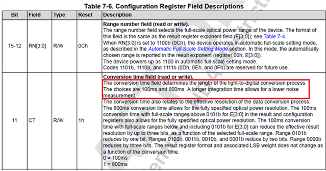

Hi Daniel,
I understand that OPT3002 store the "instanteneous" lux reading in every 100ms.
But the datasheet shows below, is it summarizing the data until 100ms (or 800ms)?
Hayashi

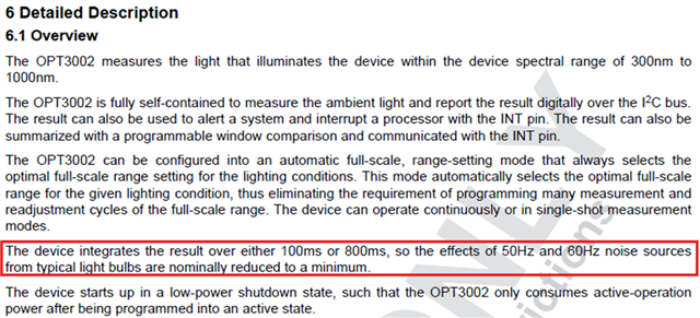

Hi Hayashi,
I believe I misinterpreted your original question. Just to clarify, you are asking whether the sensor outputs an instantaneous measurement every 100ms or if it averages the light level over 100ms, is this correct? If so, I would need to verify which approach it takes.
What is the application for this? Does the customer need a faster conversion time?
Daniel Balmaceda
Hi Daniel,
Yes that is my question.
Application is video doorbell, the sensor must detection day/night just after the system wake up from sleep. So they need faster conversion time.
Hayashi
Hi Hayashi,
Thanks for clarifying. The measurement result is integrated over the 100/800ms so it is not possible for the OPT3002 to give a faster result. What conversion time is the customer looking for?
