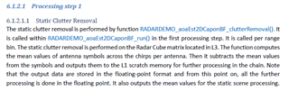

  • Hi Josh,
      I have a little confused about your reply "it is always enabled in code and no option is provided for it on the CLI for the same reasons".
    From 3D_people_tracking_demo_implementation_guide.pdf, it mentions "The static clutter removal is performed by function RADARDEMO_aoaEst2DCaponBF_clutterRemoval().
    From the source code, this function will do nothing since it's not defined RADARDEMO_AOARADARCUDE_RNGCHIRPANT in 3D people tracking.
    Can you please help to check it again?
    Thanks.
    RADARDEMO_AOARADARCUDE_RNGCHIRPANT is defined in RADARDEMO_aoaEst2DCaponBF.h
    {RADAR_TOOLBOX_INSTALL}\source\ti\dpu\capon3d\modules\DoA\CaponBF2D\api
    Josh

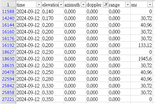

      I can see the doppler value of point cloud is zero in my experiment. Can you please help to explain this result?
    Thanks.

  • Hi Josh,
      The experiment is only put mmWave sensor in the desktop and record the point clouds information.
    Thanks.

    Sorry for the delayed response here.
    Are you using the prebuilt binary files and which configuration are you using?
    If you could provide more information about the data captured in your screenshot it would be helpful. For example, how are you capturing and parsing the data from the device? It appears that there are >27000 rows in the data that you are showing, am I correct to assume that all of these are detected points in the point cloud and only ~15 points have a doppler value of 0? Also, since the points seem to have 0 for azimuth and range I am wondering if these are even valid detections or if there is some issue with the parsing/corrupt data/something else. I'll keep looking into this to see if this issue of invalid points is a known issue and get back to you with my findings in the next couple of days.

  • Hi Josh,
      Let's clarify the environment setup in my experiment first.
    Device: IWR6843-ODS
    Example: 3D People tracking
    Radar firmware: prebuilt binary file 3D_people_track_6843_demo.bin in radar_toolbox_2_00_00_06\source\ti\examples\People_Tracking\3D_People_Tracking\prebuilt_binaries )
    Radar config:  ODS_6m_default.cfg in radar_toolbox_2_00_00_06\source\ti\examples\People_Tracking\3D_People_Tracking\chirp_configs
    Steps:
    1. Modify parseTLVs.py in radar_toolbox_2_00_00_06\tools\visualizers\Applications_Visualizer\common to save point clouds information.
       The change is only add save point clouds inforamtion to file in parseCompressedSphericalPointCloudTLV()
    2. Run gui_main.py in radar_toolbox_2_00_00_06\tools\visualizers\Applications_Visualizer\Industrial_Visualizer
    3. Start mmWave sensor
    4. Put the mmWave sensor in desktop and monitor point clouds information.
    I do the experiment again in this morning and get the same result. There are 7 points with zero doppler value.
    Can you please help to check it?
    I attached the full point clouds information for your reference.
    20240925-095316.csv

    Thank you for your patience. After checking further this issue has been reported before but it is rare and believed to be a UART transmission error. Does this seem to make sense with your tests? If it is only a few points out of tens of thousands of points captured then I believe it could be a possibility.
    If you have the raw UART streams saved you can retry manually parsing in the data and check for the possibility of some bit error.
