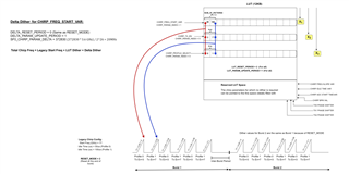

  • Dear Shruti,
    thank you for your response! For each TX, I can enter four values in mmWaveStudio. The documentation you recommended states that "four types of control can be achieved on each parameters of a chirp" and lists "3. Delta increment every N chirps: On top of sequence of unique chirps from LUT, the fixed delta increment can be done every N chirps." Is my assumption correct that I have to enter a phase value in the third row of the text fields shown in the screenshot below in order to achieve a fixed phase delta across the chirps of a frame? I would like to start with phase offset 0 for the first chirp in the frame, then have an offset of 1x, 2x, 3x (...) for chirps 2, 3, 4 (...) and start over with 0 again in the next frame.
    BR,
    Fab
  • Hi Fab,
    Here the fixed delta doesn't mean that you will get the constant phase between the N chirps. using the fields given in the studio gui you can fix some customizable fixed delta between the chirps.
    for example, if we configure the 4 rows for delta with the following phases 15, 35, 45, 70 degrees and suppose our reference/default phase is 90 degrees.
    then for the above case the first chirp will have 90+15, the next chirp will have 90+35, followed by 90+45 and 90+70 degrees of phase shift, if we have more number of chirps in the series the frame then this pattern will repeat i.e. again the next chirp will have 90+15.....90+70 degrees of phase shift.
    for your use case that you have mentioned, i.e. to have a phase shift like 1x,2x,3x for the continuous chirps, you can configure the fields with values like 30, 60,90 and so on...
    Hope this resolves your query.
    Shruti

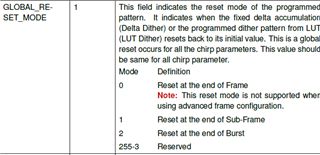

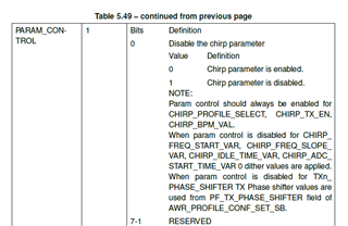

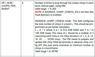

  • Hi Fab,
    This setting is incorrect as below.
    ar1.ProfileConfig(0, 77.100000018, 4, 1, 60, 0, 0, 0, 0, 0, 0, 0, 0, 15.981, 0, 2048, 42667, 2216755200, 0, 30, 0, 0, 0)
    Here you are selecting VCO1
    As per the ICD the frequency is be within 76 to 77 GHz only whereas your start frequency is over 77 GHz.
    Also please refer to the ICD as well when configuring the Advance chirp parameters.
