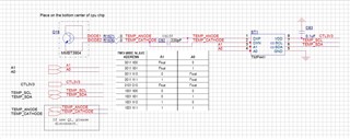

Hi Team,
Below is the schematic:
The data in register jump. Below is the data captured per 1 second:
[09-13-05-30-13]bus(0xf) addr(0x4d) off(0x0) tmp(0x48)
[09-13-05-30-14]bus(0xf) addr(0x4d) off(0x0) tmp(0x5f)

Could you please review the schematic and tell me how to solve this problem?
  • Hello Moon,
    I do not see any issues with the schematic. Thank you for providing the register dump. I looks like the only change that was implemented was the enabling the remote channel, local channel, and resistance correction. I see that the local data was provided, is the remote channel acting in the same way? What temperature are you expecting? What application is the temperature sensor being used for?

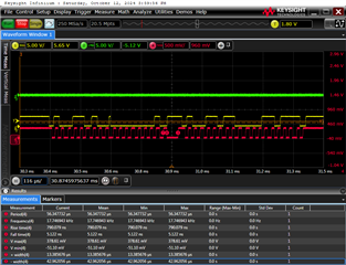

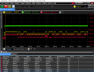

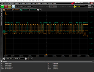

  • 您好,
    这是IIC的波形,目前怀疑是软件在IIC读操作时,出现读取异常。因为I2C读取是通过GPIO模拟的,并不是用IIC控制器。但是软件说没有报错。
  • Hello Moon,
    Thank you for providing the screen shots. Does the temperature error happen consistently?
