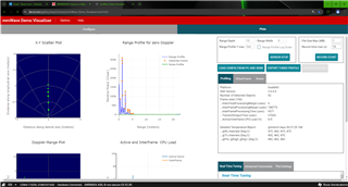

  • Hello Zigang,
    I apologize for forgetting to attach the visualizer output. The figure on the left shows the Range Profile with the original configuration, while the figure on the right corresponds to the modified configuration where the Tx power was reduced by 6 dB. As expected, the amplitude decreases by a factor of four.
    Please note that the first peak represents the reflector, while the second, larger peak is from the ground reflection.
    Additionally, I conducted the experiment with different Tx power levels, but the outputs remained consistent across all variations.
  • HI, there:
    That is really strange.  Can you double check the configuration that loaded in visualizer is the one you made the change?
    Zigang

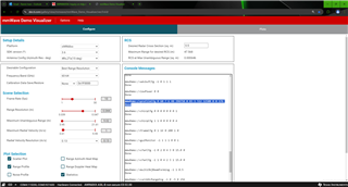

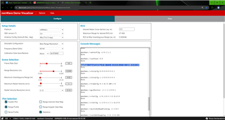

  • Hello Zigang,
    Thank you for your help and attention. Attached are screenshots of the console and the corresponding Range Profile after loading the configuration with the two specified output powers. However, I still do not see any significant changes.
  • Which demo you are using? Mine was shown a range profile in dB (instead of linear) and the level change looks right to me.
    Zigang
    I am using mmwave_sdk_03_06_02_00-LTS. Fortunately, with the help of your comments, I was able to identify the issue. The problem was caused by the short distance between the reflector and the sensor. The reflected power was significantly higher than the sensor’s memory capacity, causing memory saturation. Even after reducing the power, the reflection remained strong enough to saturate the memory. I replaced the reflector with a smaller aluminum plate, which allowed me to observe differences in the output, although the results still do not seem accurate. I will ask this in another thread.
