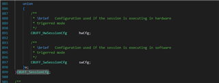

hw : awr2944evm + dca1000.
sw : sdk <mmwave_mcuplus_sdk_04_04_01_02>
<C:\ti\mmwave_mcuplus_sdk_04_04_01_02\mmwave_mcuplus_sdk_04_04_01_02\ti\demo\awr294x\mmw>

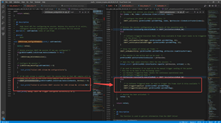

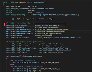

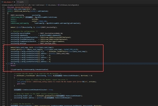

1 : only add these code as picture below.
if(gMmwMssMCB.lvdsStream.swSessionHandle != NULL)
            MmwDemo_LVDSStreamDeleteSwSession();
if (MmwDemo_LVDSStreamSwConfig(0, NULL, NULL) < 0)
            MmwDemo_debugAssert(0);
CacheP_wb((void *)&gMmwMssMCB.lvdsStream.swSessionHSIHeader, sizeof(gMmwMssMCB.lvdsStream.swSessionHSIHeader), CacheP_TYPE_ALL);
if(CBUFF_activateSession(gMmwMssMCB.lvdsStream.swSessionHandle, &errCode) < 0)

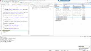

2 : Run this App.

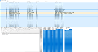

3 : expected header and data received.

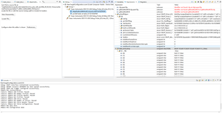

4 : unexpected cbuff error interrupt triggered.

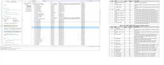

5 : in cbuff error, register  STAT_CBUFF_REG1.
Q1 : why the cbuff error interrupt triggered.
Q2 : how to solve it.
