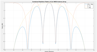

The azimuthal HPBW on the AWR1843BOOST is very wide and it does not align well with our application of wall detection at a distance. Is there a possibility to reduce the HPBW through beam forming. The attached picture is what I intend to achieve. This photo is taken from the documentation on MIMO Radar from Math works. Per the theory behind beamforming, I must enable both Tx antennae in the azimuth plane at the same time. How do I achieve that in the software?
Moreover, as I understand, the BPM-MIMO serves the purpose well as it offers simultaneous transmission from both Tx antennae and allows for fine angular resolution as well. However, if we are not interested in angular resolution at all and the aim is to just reduce the HPBW and receive the reflected signal with a single Rx antenna then how does the situation change.

    2. I am also aware of the MRR beam steering example but I need some clarity on the radiation pattern. Since the antenna are separated by 2λ, the radiation pattern will have multiple grating lobes instead of a single main lobe in the center. Check the "Tx Pattern" in the attached picture of my original post.
    The documentation in MATLAB from where I took the picture suggests that the MIMO radar with the ability to create a virtual antenna array of 8 receive antennae with 2 Tx and 4 Rx physical antenna resolves this problem. As I understand, if I use 2 Tx-R 4x BPM-MIMO, I shall have a reduced HPBW and the issues of grating lobes will be resolved?
    What if I want a 2 Tx- 1 Rx configuration where the aim of having 2 Tx is just to reduce the HPBW and the only 01 receiver chain to keep the computation latency to a bare minimum. Given the grating lobes issue, it might not be a possibility.
    I need your guidance in this matter because I dont have a compact antenna testing range (CATR) to characterize radiation pattern at 77 GHz frequency. The MATLAB simulations is all I am relying upon.

  • In the meantime, I was able to perform a simulation in MATLAB and this is what I got. Compare this blue curve with the blue curve of the picture in the original post. Your comments on the simulation results are highly solicited.
    Best Regards
    Maaz Ali Awan
