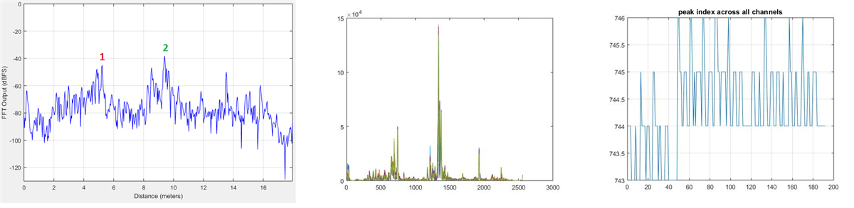

As the results of the calibration using the adjusted configuration seemed do be somehow off I repeated the measurements and calibration script few minutes later without adjusting anything besides the configuration file. The target reflection is marked with"1" (actual distance: 501cm), the reflection of the wall behind is marked with "2" (actual distance not measured exactly).
Results Short Range Configuration
The sampled chirp bandwidth results in a range resolution of ~3.5cm. Analyzing the samples in PostProc the peak indicates a distance of ~521cm, hence off by 21cm / 5 bins of the range resolution. Running the antenna calibration matlab script hence results in a estimated target range of 5.2013m. The reflection of the wall results in a distance of 941cm.
Results Standard MIMO Configuration
The sampled chirp bandwidth results in a range resolution of ~60cm. Analyzing the samples in PostProc the peak indicates a distance of ~480cm, hence off by 20cm, but falling within the range of the range resolution. Running the antenna calibration matlab script results in a estimated target range of 5.0344m.The reflection of the wall results in a distance of 939cm.

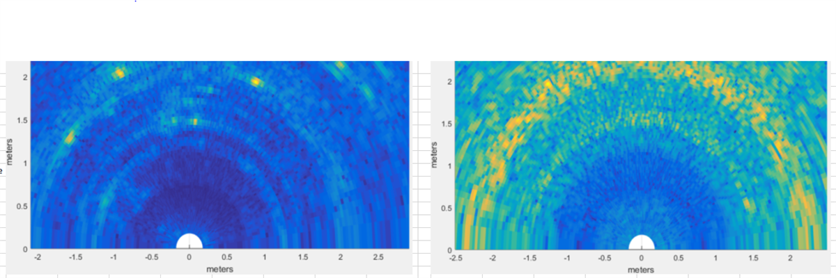

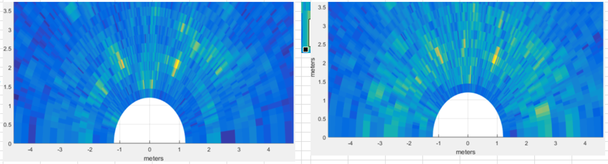

    ok, thanks! Here some data for comparison of the short range and mid range configuration. Each row is the same capture data. The left hand side of each row is the matlab post processing using the calibration matrix that has been generated with configuration data of my own, short range configuration, the right hand side is the same data, but post processing done with a calibration matrix generated with the configuration of the standard MIMO (midrange) script provided by TI.
    Mid range MIMO capture data (standard TI, same left and right)
    Short range MIMO capture data (own, same left and right)
    So to me it seem the calibration with the standard MIMO parameters is not as accurate, it seems to have problems when being used with higher bandwidth configurations.

  • Hi Felix,
    If you are using a different configuration, you need to generate the calibration matrix. You cannot use calibration matrix generated with the mid-range configuration to calibrate the data captured with short range configuration.

  • Hi Felix,
    After checking the plots (1D FFT), I have observed that there is 2cm difference for the wall that is detected using both the configurations. So, 20cm difference that you have mentioned is not uniform for all the detected objects. Can you perform few tests by moving the target to different locations and see if the results are similar?
    Can you confirm if you are using a strong reflector as your target? Also what are the dimensions of the target?
