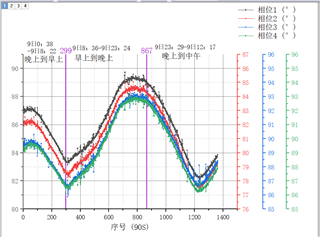

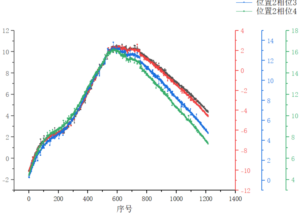

The radar measures continuously for 13.5 hours against the metal plate at a distance of 70cm, measuring once every 1.5 minutes, and calculates the phase value, and the phase is falling downward, but the change value of the four antennas is inconsistent, and why does it keep falling downward, the phase of antenna 1 changes by 8°, antenna 2 changes by 10°, and antenna 3 and 4 change by about 20°, why is this

  • HI, there:
    My understanding is the TX and RX gain will decrease as temperature increases.  So, I can imagine total gain reduced during this measurement.  Please track the gain and phase of your target at the same time.  At the same time, I would recommend using a point target (such as corner reflector) to simplify the problem.
    Please let me know how you calculate the phase and please share the setup picture and zero Doppler output plots if possible.
    Zigang

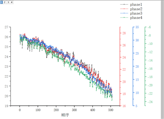

  •  This is the phase measured for 11 hours, why is the upward and downward trend of the four antennas inconsistent? The target is not moving, why is it going up and down?

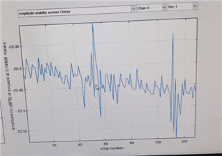

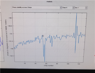

  • I've changed the target to an angular reflector, but why does the phase of 128chirps have an upward trend, and the amplitude has a downward trend,
  • Hi, there:
    As I said, the gain reduces with the temperature.  I am not sure about the phase.    After changed to corner reflector, the level of amplitude and phase drifting looks really small to me.   Let me know if this is still a concern to you.

  • But this is just one data, I have collected it more than ten times in a row, and its changes are quite significant. Moreover, the phase change of antenna 4 is significantly different from other antennas.
  • Please send me the worst results with corner reflector.
    Zigang
  •  Why do they go further and further, they don't correspond to the same phase change value?

  • HI, there:
    Across chirps within a frame:
    • Amplitude drop is expected due to thermal settling. Phase typically shows an upward trend. This is expected.

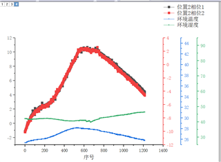

    In the long term stability test:
    • The phases of 4 receive chains track pretty well in the first half of the test. Then, something has happened to the test setup. The phases are decreasing in the second half of the test. Is the ambient temperature being reduced here?
    • Is the test performed on IWR1443 boost or another customer made platform?
    • Do you have the die temperature readouts when the 13.5 hours is performed?
    Zigang,
  •  Hello, this is the case for ambient temperature, ambient humidity, and phase. Measured with IWR1443 Boost. How do I read the temperature of the board? Want to read four different antennas?

    What is the test condition difference between this test and previous test?
    In this results, you only showed two antennas. Are all antenna have the same phase change?
    Another suggest from our system engineer is to change the target IF frequency, which equals freqSlope*2*targetRange/300. Right now, you have 66.5*2*0.748/300 = 330K, which is too close to the High pass filter corner frequency.  Can you adjust the slope or range?  so that the target falls into higher IF frequency.
    How did you get the temperature reading that shows in the figure?

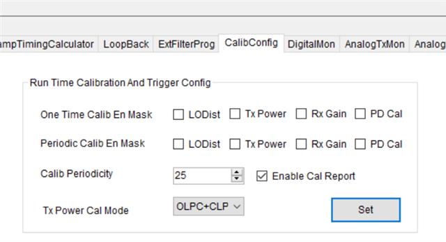

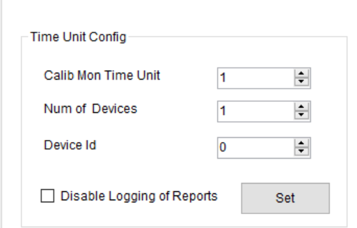

    By the way, in order to record the board temperature, you can enable the following two LUA API
    You should be able to see the temperature in the CalibrationReport.txt, looks like below.  Temperature is highlighted in yellow
    [14/10/2024 18:57:37] DeviceId [1] RunTimeCalibReport: 0, 1, 1, 1, 1, 1, 1, 1, 1, 1, 1, 1, 0, 262144, 0, 0, 0, 0, 0, 0, 0, 0, 0, 0, 0, 0, 0, 0, 49, 0, 762090, 15

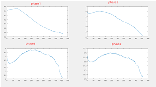

  • The two graphs are the same measurement, but in Figure 2 I only drew the phases of the two antennas. Hello, are you Chinese, I feel like you are by looking at your name
  • HI, there:
    Can you give me an update on the latest test results?  The figure below shows consistent phase change cross all antennas.   What is your main concern?  How it affect your applications?
