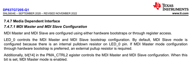

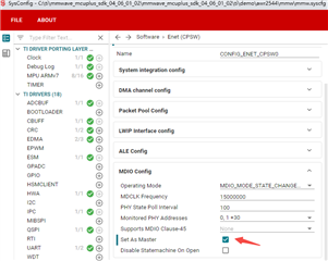

When we use 2544 Demo program (C:\ti\mmwave_mcuplus_sdk_04_06_01_02\mmwave_mcuplus_sdk_04_06_01_02\ti\demo\awr2544\mmw\ demo), Want to change the mode of Ethernet, the default is Master mode in the program, we want to change it to Slave mode, how to set it?
We have seen related posts asking similar questions, which mentioned that modifying the configuration in MDIO Config in mmw.syscfg (shown below) will not do the trick. Is there anything else that needs to be modified?
