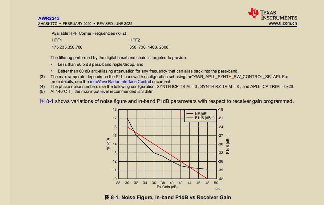

  • Hi, when RX Gain is 48,the NF will be 11, according this pictute;
    Now, devID0 and devID1 ,RX Gain is 48,
    but the NF:
      devID0 is 13dB.
      devID1 is 15dB.
    then, Compared to the standard diagram provided by TI, Chip 0 has a difference of 2dB, while Chip 1 has a difference of nearly 4dB. What are the reasons for this?
  • Hi Miles,
    There are a few things to consider here:
    1. It's very typical for there to be several dB of variation from part to part.  You need to measure a very large number of parts to get an accurate understanding.  It appears that you have two devices which are a bit over the average for NF, but statistically this can happen.
    2. If you are using the on-chip monitor to measure NF, its also important to note that the NF is measured by loopback of the TX into the RX.  Therefore, slight variations in matching at the TX can impact the accuracy of the monitor by a few dB, since the chip uses an estimate of the power coupled back into the RX to estimate the noise figure.
    James

  • Hi Miles,
    Also, I need to let you know that the NF monitor is very susceptible to interference, so we don't usually recommend its use.
    Generally, the noise figure will improve with higher gain, as shown in the plot (however, be careful since higher gain also reduces linearity, so can result in more spurs).  Also, the noise figure improves as you reduce loss into the device, so its important to keep the trace loss to the antenna and the antenna efficiency as high as possible.
    James
