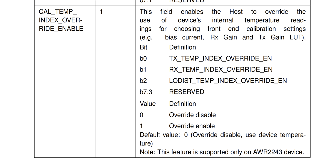

    I apologize for not expressing myself clearly earlier. What I meant to ask is about the relationship between the temperature index values [CalTempIdxTx /
    CalTempIdxRx / CalTempIdxLodist] used in runtime calibration and the gain, or rather, how should I set these temperature index values?
    For instance, if the temperature of the Tx, obtained through the radar's built-in temperature acquisition interface, is 60 degrees Celsius, should CalTempIdxTx
    be set to 10 (corresponding to the range of 60 to 70 degrees Celsius)? I have conducted tests with this setting, however, the read RX Gain was smaller than
    the set RX Gain. On the other hand, when I set CalTempIdxTx to 18 (above 140 degrees Celsius), the read RX Gain was closer to the set RX Gain.
    Miles

  • Hi Miles,
    You can set this however you want given your requirements, but please note when you maximize the gain this way at 60C, you may have a problem when you go to a lower temperature and the gain becomes too high causing linearity issues.  As it is, the chip tries to pick the best code to give good performance over the entire temperature range.
    Jamse

  • Hi Miles,
    As mentioned in the ICD:
    Enabling the override essentially allows you to override the internal temperature sensor, and force the device to use a value from the LUT that corresponds to a different temperature.  How to do this, or whether it is advisable, depends on your use case.  If you are trying to use the device over a wide temperature range, then generally it is best to allow the device to index into the LUT itself without override.
    James
