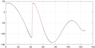

    Thank you for your reply!We set HPF=2 and Rxgain=30. The saturation problem disappears, but sometimes the ADC waveform produces step jumps, which increases the noise significantly after 2Dfft. Pls what is the reason for this and how do I fix this next. Thank you!ADC waveform_Jump

  • Hi Laijun,
    The shared ADC data plot shows that all the chirps are overlapping. Hence, we do not expect any noise after 2DFFT based on this plot. Can you please tell what are your RDIF configurations?

  • Hi Deexith,
    I'm sorry I made a mistake, this step really didn't increase the 2Dfft noise, but I think there will be a change in the distance dimension at zero velocity.  It's uncertain if this could cause other problems.
    The radar is mounted on the door of the car and the data is collected when electromagnetic waves are emitted into the car. The ADC .xlsx data  for the TX0RX0 is available in the  attachment(chirp:128,dot:128). Correspondence this figure:
