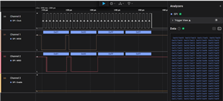

  • I have been monitoring the transactions using a Logic Analyzer. When CPHA is set to 1, no data is shifted. However, when CPHA is set to 0, data is shifted.
    According to the datasheet, the TMP126 can operate at a maximum of 10 MHz. I initially configured it to 5.625 MHz but later changed it to 0.7 MHz as you recommended and captured the data for your reference. Despite this, I still encounter issues with chip configuration and data reading.
    Below is a snapshot when CPHA = 1:
    Data representation (Micro DataOut / Micro DataIn):
    1. First Data: Write command for configuration register (reset command): RegAddr = 0x0003, Data = 0x0100
    2. Delay: 1 ms
    3. Second Data: Write command for configuration register: RegAddr = 0x0003, Data = 0x0002 (Continuous Conversion 62.5 ms)
    4. Third Data: Read command to verify the configuration register. Responds with 0x0000
    The rest follows the configuration for the Alert Enable register, Temp Low Limit, High Limit, Hysteresis, Temperature Slew Rate Limit, and continuous temperature result register.
    When CPHA = 1, the write command values are proper, but there is no response from the TMP126.
    The below snapshot is to show the synchronization between the data and SCLK.

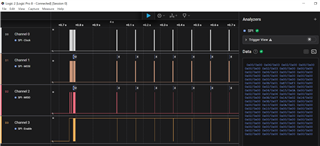

    Below is a snapshot when CPHA = 0:
    It appears that the write/read command values are disturbed while sending them over the SPI bus, as shown below:

  • You will have to configure both your host controller and your logic analyzer for the same CPOL and CPHA settings to avoid having the data appear shifted or incorrect in the analyzer.
    Looking at the TMP126EVM, I can see that it is using CPOL=1 CPHA=1 communication as shown here:
    The data shown is the shared SIO pin at the TMP126. I'm not able to probe the MOSI pin before the resistor like in your setup. Note that the host must transmit 0xFF 0xFF for the 3rd and 4th bytes to allow the TMP126 to respond during this period. I don't see this happening in your captures.
    I recommended using CPOL=0 CPHA=0 because the datasheet shows the clock idling low. I can change the TMP126EVM GUI to transmit using CPOL=0 CPHA=0 and it looks like this:
    Both of the transactions I'm sharing are a read of the device ID register 0x0C. My prototype TMP126 is reporting an ID of 0x0126 where the datasheet states a production sample should report 0x2126. At any rate, CPOL1/CPHA1 is a complementary configuration to CPOL0/CPHA0. As you can see, they both work with TMP126. However, a CPOL1/CPHA0 or CPOL0/CPHA1 configuration will be incompatible with TMP126.
    Let me know if this helps clear up your confusion regarding CPOL/CPHA.
    I did notice that something is pulling down your MISO line during the first byte. This shouldn't be coming from TMP126 - are your SPI pins shared with another device?
    Your analyzer is capable of logging analog, and I would like to see it if you could share it. This is to address the pull-up and bus frequency concern.
