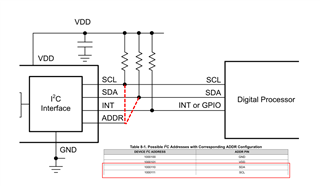

Dear Ti members,
about i2c ADDR setting ,
does it correct connection as below for ADDR to SDA or SCL ?
Dear Ti members,
Yes, those are the correct connections from SCL and SDA to the ADDR pin.
