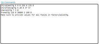

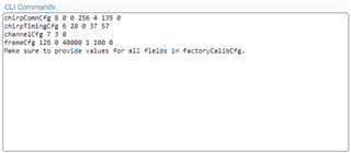

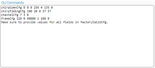

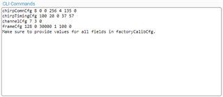

I am dealing with the chirp design, and I am using mmwave sensing estimator.
Below are to configurations that I used. The only difference is that the first one (left) is using smaller idle time, and the second (right) is using larger idle time.
The second configuration (100 us of idle time) works well in the IWRL6432 EVM. It seems that it is the problem of the lack of idle time. My question is: how can I know the the down chirping slope? or how can I know the sufficient time of the idle time?
Thanks!
