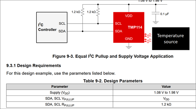

Hi, Support Team
We are design in TMP114. For power consumption reduction, we would add 4.7k ohm pull-up resistors with 1.8V power supply.
Is it possible for TMP114?
if any suggestion, Please advise me.
Lawrence
  • Hi Lawrence,
    Having a 4.7k ohm pullup would be ok with this device. Keep in mind the input capacitance spec for the digital pins which is 10pF at 100kHz. A weaker pullup will have a lower maximum frequency for the communication lines due to input and parasitic capacitance. Just something to note if you want to use a higher pullup to run at high I2C frequencies.

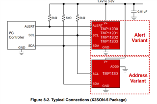

    There should three parameters to determine the maximum pull-high resistors: Cb, Rp, Tr
    Tr is related to the I2C driving frequency, the max frequency of TMP114 is 1MHz, it’s same as TMP112D.
    So I think it could have the same pull-high resistors of TMP112D, like below. Is that right?
    Lawrence
  • Hi Lawrence,
    Yes, the higher the frequency and the parasitic capacitance, the smaller the max pullup resistance is. Assuming your maximum parasitic capacitance is the 10pF, yes 5k or 4.7k ohms is ok.
