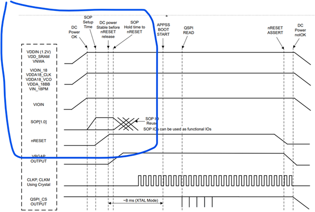

The datasheet of IWR6843 indicates that the device wake-up sequence is shown in the figure below.
Do you have any specifications regarding the delay time between these four power rails?
"VDDIN (1.2v), VDD_SRAM, VNWA"
"VIOIN_18, VIN18_CLK, VIOIN_18VCO, VIN18_BB, VIN_18PM"
"VIOIN"
"SOP (1,0)"
