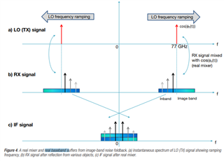

Is there any example to show inband and image band?
For example ,
START frequency is 76.1 GHz
ADC Sampling frequency (ksps): 4632
What does inband and image band mean?

Hi Bruce,
We do not have a specific example but since AWR1843 receiver system uses IQ structure, the image will be rejected, and the IF signal will be the tone in the positive frequency/Real axis. Following this, there is a second order high pass filter and a low pass filter for isolation.
It is also mentioned in the following app note which I believe you are referencing from Complex base band arch. For FMCW radar systems (Auto) - IQ
