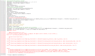

  I am running the DataCaptureDemo_xWR.lua script in mmWave Studio 02.01.01.00. I am using IWR1443BOOST and DCA1000EVM. I want to capture the raw ADC IQ data but getting the following errors.
[15:38:32] [RadarAPI]: ar1.CaptureCardConfig_EthInit("192.168.33.30", "192.168.33.180", "c:22:38:4e:5a:c", 4096, 4098)
[15:38:33] [RadarAPI]: Sending fpga command to DCA1000
[15:38:43] [RadarAPI]:
[15:38:43] FPGA Configuration :
[15:38:43] Timeout Error! System disconnected
[15:38:43] [RadarAPI]: Sending fpga_version command to DCA1000
[15:38:53] [RadarAPI]:
[15:38:53]
[15:38:53] Unable to read FPGA Version. [error -5]
I checked the "error -5" in DCA1000 Debugging Handbook. I tried the following debug methods.
1. I tried with different ethernet and usb cables.
2. I checked that the firewall is turned off and the ip is set to "192.168.33.30".
3. I tried with different PC.
4. I reflashed the FPGA using Diamond Programmer 3.14 to the latest version i.e., 2.8.
5. I tried with a different DCA1000EVM board.
Still I am getting the same issue. Kindly suggest any other solution.

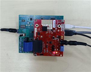

    I am using 5V,2A power supply. Below is the photograph of the same.
    I am using 60 pin connector to connect DCA1000EVM to IWR1443BOOST. Below is the photograph of the physical setup.

  • Hello Arnab,
    Your Ethernet adapter will have to be gigabit and what you have shown is a 100Mbps adapter. The reason for this limitation is because the FPGA does not have a processor core to implement all the Ethernet MAC address features. So it was hard coded to operate in 1Gbps mode.  You could use a USB-to-Gigabit Ethernet adapter that offers speeds of 1Gbps. We also recommend a 5V 3A power supply. We have come across cases where a 5V 2.5A supply prevented a DCA1000 from starting up, so a 2A power supply can very much be the cause as well.

  • Hi Pedrhom,
       I changed the ethernet speed property to 1 Gbps from 100 Mbps and it worked.
    Thank you for your valuable insights.
