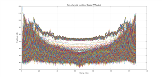

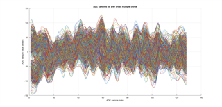

Now I would like to do post processing. I started to run your MATLAB script (dataPostProc_lowPowerDevice.m) with a record of 50 frames.
I obtained this two plots:
Is there any documentation to explain these results?
Pablo
  • Hi, Pablo:
    It should be easy to understand the ADC samples.  The top one is amplitude of Doppler FFT output but with all antenna uncoherently combined.  Different curve is different Doppler bins.
    I would recommend you to
    -- Re-take the data with a static scene (no moving object).  In this way, you should expect all the ADC chirps on top of each other, and all non-zero Doppler bins are at the noise level well below the zero Doppler signal level.
